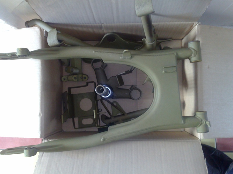

[img]Honda CB400N superdream cafe project, ALL MOST FINISHED, NEW PHOTOS Frame_11[/img]
by this time its getting cold out, so the engine ends up in the livingroom. The frame and bits and bobs head off for sandblasting...
[img]Honda CB400N superdream cafe project, ALL MOST FINISHED, NEW PHOTOS Frame_12[/img]

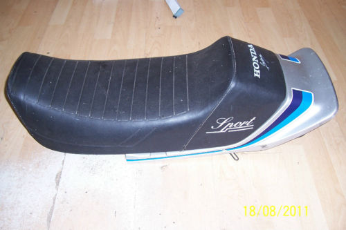

Got this old seat of ebay for £50..... I stripped everything off the seat pan...
[img]Honda CB400N superdream cafe project, ALL MOST FINISHED, NEW PHOTOS Honda_15[/img]

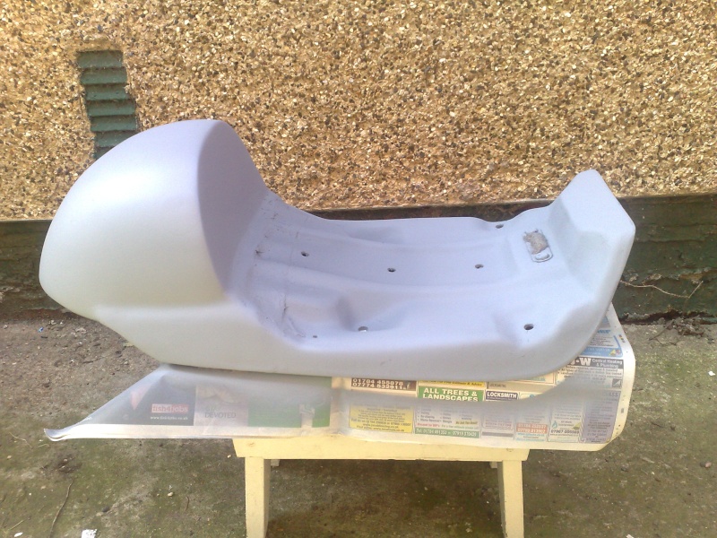

I chopped up the seat and made the hump and fiber glassed them together....
[img]Honda CB400N superdream cafe project, ALL MOST FINISHED, NEW PHOTOS Primer11[/img]
[img]Honda CB400N superdream cafe project, ALL MOST FINISHED, NEW PHOTOS Seat_b11[/img]
[img]Honda CB400N superdream cafe project, ALL MOST FINISHED, NEW PHOTOS Seat_p10[/img]

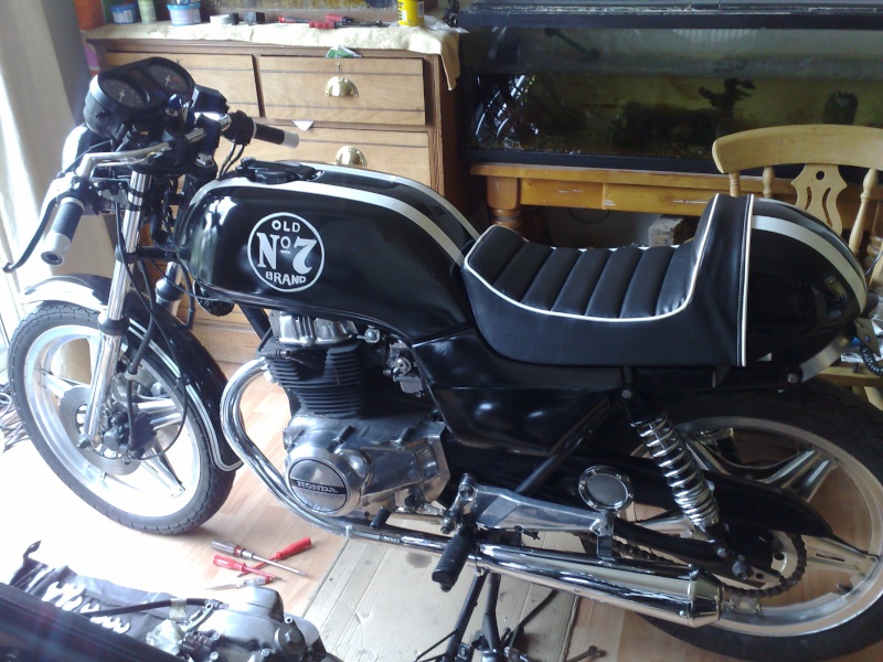

Im getting there.... I reckon I will be finished by the end of Feb, well maybe.... Here some more pics.
[img]Honda CB400N superdream cafe project, ALL MOST FINISHED, NEW PHOTOS Engine15[/img]
[img]Honda CB400N superdream cafe project, ALL MOST FINISHED, NEW PHOTOS Day2_111[/img]
[img]Honda CB400N superdream cafe project, ALL MOST FINISHED, NEW PHOTOS Clocks10[/img]
Iv not got much more to do part from figuring out the wiring, put the chain on and sort out the exhaust then the tuning to be done... I was looking at some of the other projects on here and thinking maybe I should move the wiring under the seat but then I will have to mess about with the seat.. so i might just stick to my original idea and keep everything behind the side panels...

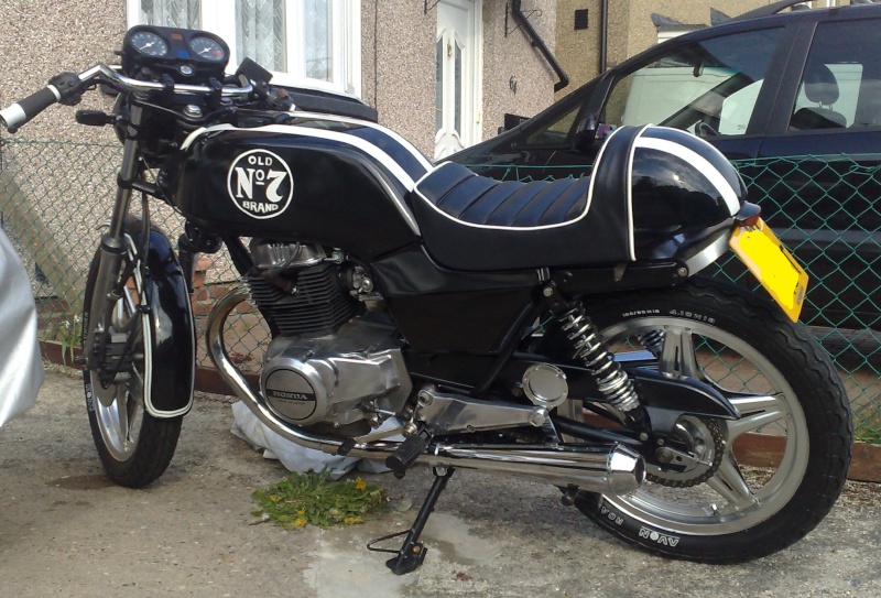

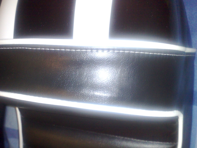

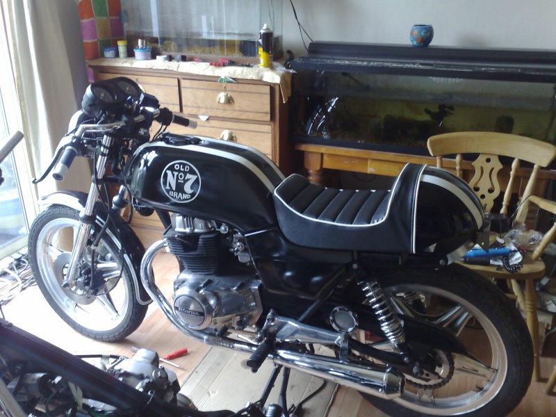

[img]Honda CB400N superdream cafe project, ALL MOST FINISHED, NEW PHOTOS 14022010[/img]
[img]Honda CB400N superdream cafe project, ALL MOST FINISHED, NEW PHOTOS 14022011[/img]
All most finished now... ready for a tune up and M.O.T....
Very happy with the way it came out... cant wait to take it out for a ride....
I will post some better photos when I get it out of the livingroom....

looking sweet.
i used to know a bloke who built a chopper in his livingroom.
unfortunately it wouldnt go out the door and he ended up removing part of a wall rather than disassemble it. scratch

thats a beaut Harriett you must be well proud of what youve acheived Wink Wink
hope my seat turns out as good as yours Cool
so whats the other halfs project ?

It a Honda cb550 K or F 1979 chop... but having really headache with the wiring... As the last person who own it chopped all the wiring out and put back just the bog standard of head lamp brake light and ignition with bits of wire taped together... cant get anything working......
I am happy with my bike but paint work not perfect but not bad for halfords spray paint, but I think I may invest in a spray gun for the next one..... I'm just being picky....

Hi,
Amazing work, looks fantastic!
How did you mould the seat hump? Never done any glassing before, is it easy enough?
Looks the dogs danglies, gotta say Cool Very Happy

Si78 wrote:
Hi,
Si
Hi Si, glassing is easy but the only thing is you have to be lighting fast before it sets. You can get all the stuff you need from Halfords....
You can build your mould from plywood then fill the gaps with expanding foam then sand it down. Then once you have the shape you want.... cover with cling film, then sort out the glass fibre sheets, you can just use the sheet whole but I find it an arse to work with, so I cut it into strips easier to work into corner.. And with strips you can criss cross and make it stronger.. I would do about 4 to 6 layers. After it hard which won’t take long at all. Use some body filler to finish and smooth out and sand with 800, 1200 2000 grit, and then use filler primer sand with 2000. Then paint....

Thanks for that Harriett, you make it sound easy enough. Looking forward to giving it a try! I'm sure I will get messy...
Cheers,
Si
